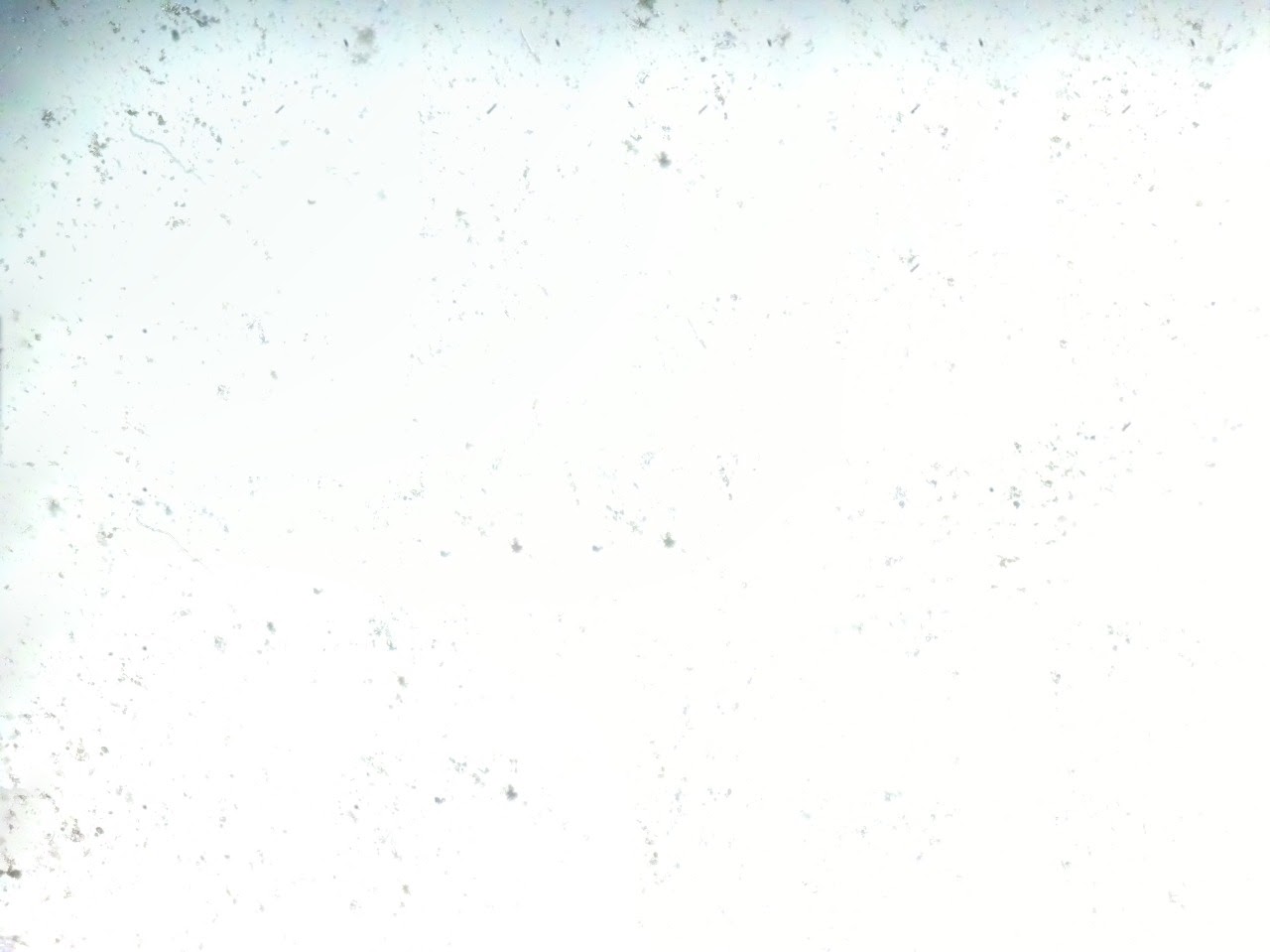

I’m interested on testing OFM phase contrast imaging on soil samples. My idea is to scan soil samples and stitch images to make some sort of soil microlandscapes ( ala Winogradsky). I’ve made a few experiments with a regular OFM (RPi optics) and the Image composite editor software.
→ second image is a 25 images composition. first image is the upper left corner of the composite (foreground fungal hyphae filament)
