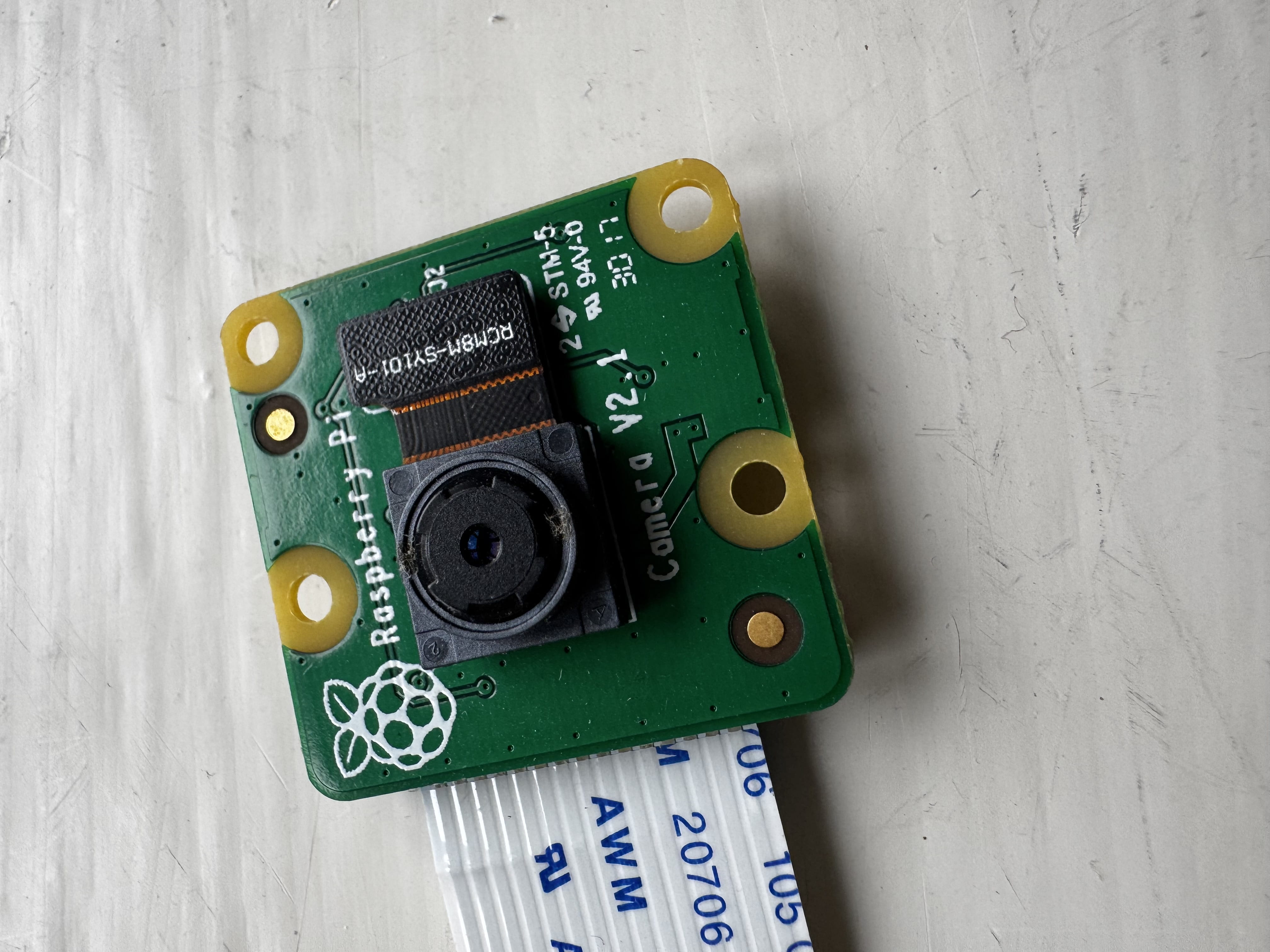

I wonder if my old camera v2.1 module here is good to start with https://s.natalian.org/2025-02-15/cam.jpeg ?

The camera module 2 is the only one supported at the moment by the ofm software and hardware, so yours should work just fine.
