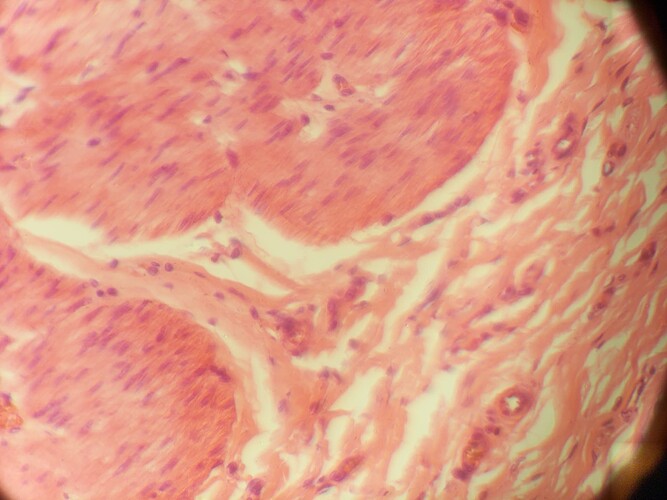

Today I assembled my openflexure microscope with the hq camera and here are some first impression of my tests:
40x objective:
