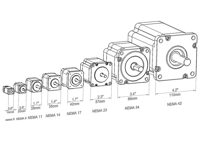

You may do better with a smaller NEMA motor:
image from https://www.omc-stepperonline.com/stepper-motors
