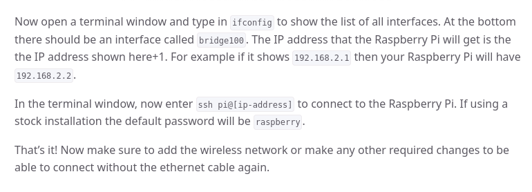

The internet seems to think that it should use the internal bridge connection and assign an IP address where the last digit is 1 higher than the address reported in ifconfig

If you can ping the OFM, that suggests there is a connection - but perhaps something else is getting confused. The first thing I’d check is what you mean by “ping the OFM” - if you mean running something like ping microscope.local in a terminal, it strongly suggests there is a working network connection. The output of the ping command likely also contains the IP address of the microscope, which can be very useful: I find that it’s sometimes the case that mDNS addresses (i.e. addresses ending .local) are resolved differently by different tools.
I’ve seen you have used the OFM quite extensively so please forgive the very basic question, but what exactly are you typing in the address bar when the web browser says it’s offline? About half the time when that happens to me, it’s because I made a typo, or I typed https instead of http, or I forgot to add the :5000. Sometimes it can also help to use the IP address rather than the hostname (e.g. entering http://169.254.123.456:5000/ instead of http://microscope.local:5000/). If ping has succeeded, you will often have the IP address in the output of that command.

It works! The solution was indeed using the IP address instead of the [OFM’s name.local]. Thank you so much for your advice!
