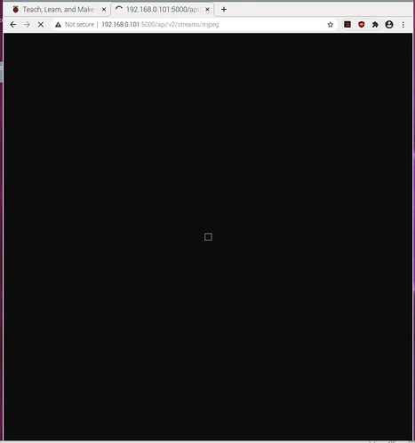

yep… The browser shows a small white square when the feed cuts out

aah that explains, I was connecting to the Rpi over VNC viewer, once I attached a monitor directly to it I managed to see the GPU preview!
With the GPU preview enabled I was unable to replicate the bug (though I did notice that the GPU preview seemed to stick around on my screen when the client closed, requiring a reboot to fix)
I think it may indeed be something like a bandwidth problem with the stream, the GPU preview also appears to move more smoothly (higher framerate perhaps?)
