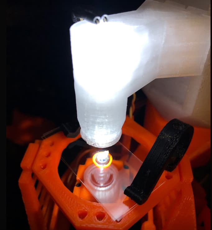

Running version 2.10.0b2. I am very sure the 5mm white LED is bright enough and I have illumination len. You can see the iimage as attached supposed to be a brown dried leaf but it is green and fresh lol.
I think from the photo you can tell the LED is bright enough.
